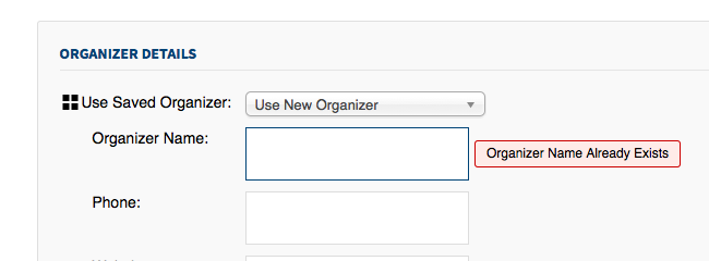

    Community event form during data entry displays “Organizer Name Already Exists” and/or “Venue Name Already Exists”.
    Prior to submitting the form.
    May display this message before the field forms are filled in.
    The venue/organizer does not exist.

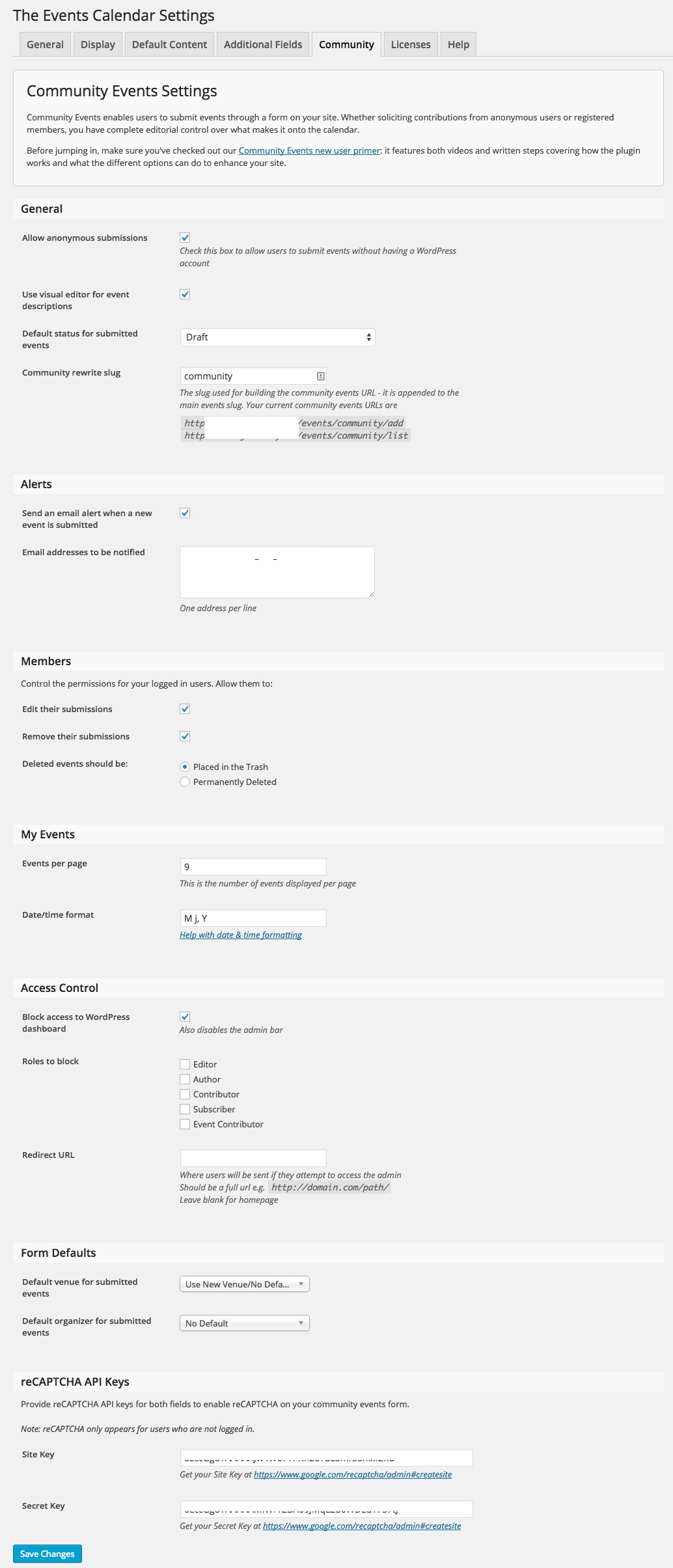

    Settings? Here’s the community events settings page.

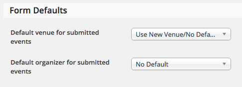

    I’ve set Community Events on my local site following your settings (logged-in or as anon), but I’m not seeing any errors. So not really sure what’s happening here. Just out of curiosity, Do you have any values set for Venues or Organizers in the ‘Default Content’ tab?

    The defaults for organizer and venue are both “No default”.
    The message does not appear immediately; floats to the right of the input field:

    I’ve found I can sometimes just wait for the “already exists” flag to appear spontaneously, sometimes I enter a few characters or fields and wait.

    Thanks for sending over the URL! I’ve tested the on your site and I could narrow down this down to the a back-end issue (apparently). Everything looks good on the ajax call but the ‘check for existing venue/organizer’ function is always returning ‘0’ which means that there’s an existing venue/organizer with that name. The function runs a SQL to check on this, so I guess the error might be with the query itself, Can you check the server error logs for any clues on this?

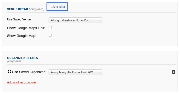

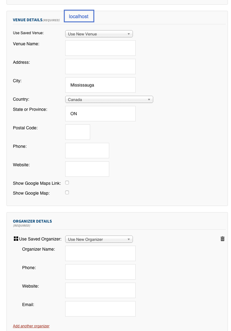

    Using data I can provide: I’ve found an anomaly between the anonymous submission form displayed on the live site versus localhost where fields for organizer and venue are displayed very differently.
    0. Both sites are configured identically in “Community Events Settings”:
    Which is the expected, correct scenario for logged-in users?
    1. On localhost both organizer and venue accept creation of new entries:
    2. On live hosting both organizer and venue do not allow for creation of new entries:

    From what you show me the local behaviour is the default behavior for sure. Do you have any configuration that might be messing up with user roles/capabilities? If you allow anonymous submissions in the live site, Does it allow new venue/organizer creation?
    The code itself that outputs the Add New option is the following:
    $venue_pto = get_post_type_object( self::VENUE_POST_TYPE );
    if ( ! empty( $venue_pto->cap->create_posts ) && current_user_can( $venue_pto->cap->create_posts )) {
    echo '<option value="0">' . esc_html( sprintf( __( 'Use New %s', 'tribe-events-calendar' ), $this->singular_venue_label ) ) . '</option>';
    So maybe there’s some configuration on user roles that is preventing this from printing out?
    Nico
    I don’t know of any config that would come into play with user roles. Anonymous submissions are allowed on both sites, only the live site disallows creating new venues/organizers. The TEC Community Events > Access Control config is “Block access to WordPress dashboard”=selected, all other options are not set.
    So maybe thereโ€™s some configuration on user roles that is preventing this from printing out?
    Perhaps? Except that the unexpected behaviour is shown when the user is not logged-in, adding their events anonymously. It appear that the single (?) most significant difference is the delivering host server. I’ll provide the System Information for both installations in another, private post.
