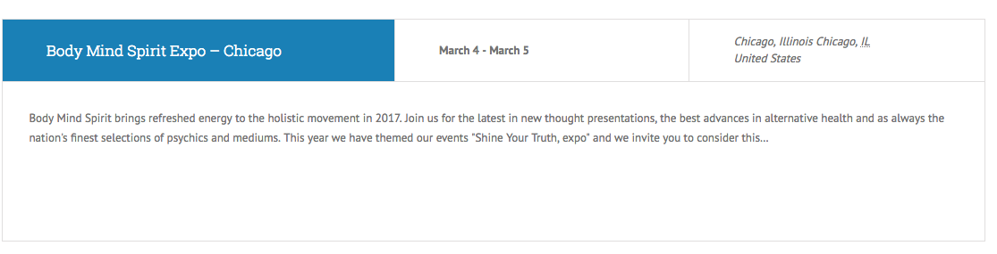

    Okay, you say that in the items view (which I think is the “List View”) that every item is messed up.
    Here is a screenshot of one specific item in that view, for reference and so that we can be talking about the same exact thing (click for a larger-sized image):
    ☝️ What is it about this item that is “messed up”, specifically? Describe what you expect to be happening with the display of this item, compared to what is actually happening with the display of this item.

    That example, like all the others does not display full text which is not that much. And on the ones it does show full text paragraphs are smashed together, no bullets, no bold fonts, no hyperlinks, not able to use color. Just like you wrote about in your document from 6/16 when you explained that changes were made that has affected the appearance.
    At this point I’m all good so take a look now. I just paid a Fiverr guy to fix it and in about a day he got it done by putting PHP code in the child theme. Says it won’t break again but if it does to let him know. Here is what he did so others that have same issues as me, have a solution. And if anyone needs help w/coding stuff I’ve included the name of the Fiverr guy because he rocked it!
    logicdigger ( name of Fiverr guy)
    You should you child theme to save changes from updates . we have edited theme -> tribe-events -> list -> single-event.php and theme -> tribe-events -> single-event.php
    Yes in child theme you can find single-event.php
    location 1 on avada child -> tribe-events -> list -> single-event.php
    location 2 on avada child -> tribe-events -> single-event.php
    Replace line number 68 code <?php // echo tribe_events_get_the_excerpt( null, wp_kses_allowed_html( ‘post’ ) ); ?>
    with
    <?php the_content(); ?>
    in theme-> tribe-events->list-> single-events.php
    its fixed no any css changes we have made
    yes it will never break you can ping me if any issues in future – Warm regards
