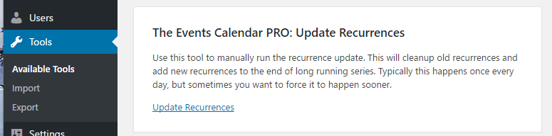

    I wrote a small extension/tool that packages the above into a lovely UI. If you download, install and activate this plugin you will find a new tool in WP Admin > Tools > Available Tools: tribe-ext-recurrence-update-0-1-0
    That tool will have this UI. Just click the button to force an update.
    screenshot
    Did that do the trick or are you still having issues? If you’re still having issues, do you have a staging server setup that we could login to? We would not change any settings or anything while logged in. But it could really help speed things up if we could examin the events settings. If this is something you’re interested in, please:
