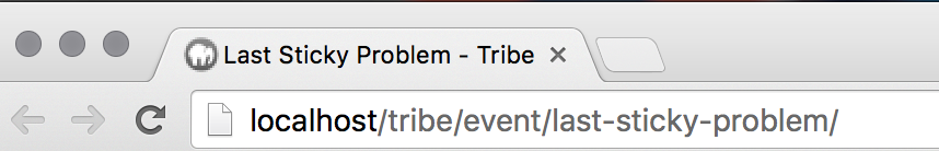

    #1087285
    Hi and thanks for the response,
    I’m not involved with the demo site (admittedly, it appears it could use some updating) – and as I said, I’m unable to reproduce the issue on my local environment. One recommendation would be to install an SEO plugin so you have better control over your event titles (I use Yoast’s WordPress SEO, see screenshot of past event on my local environment below).
    I’ll bring up this conversation to the other team members and the product developers for insight on how we can improve how our plugin handles SEO titles. We are always looking to enhance the performance and experience for everyone involved.
    Thank you again for the patience and detailed responses throughout our interaction. Best of luck and enjoy your day.
