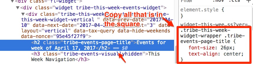

Using inspect I found the CSS for the widget title but am not sure what to include in the
CSS? See attached pic…. I can edit it manually but not sure how to change it in CSS?Q2:

Q1: The font size worked after adding the important! arg
CSS? See attached pic…. I can edit it manually but not sure how to change it in CSS?Once you find the CSS rule and you change it to your liking, you will need to copy-paste all of it over to the style.css file of your theme or in your Custom CSS metabox.
If you can’t find either of these 2 things, the you should install the following plugin: https://wordpress.org/plugins/simple-custom-css/

Q1: I have been using the simple custom css plugin for awhile and works fine.
I had previous added the highlighted css when I changed the font size.
What do I do with the other H2 line that you highlighted? That is the place I manually
change the title and it worked, but not sure where to put that line? See attached pic.Q3: I replaced the code in line 17 of the file under my child theme in the path you

What do I do with the other H2 line that you highlighted? That is the place I manually change the title and it worked, but not sure where to put that line? See attached pic.
I believe there is a bit of confusion here. CSS files or Simple Custom CSS boxes are not meant to handle HTML elements, only the CSS rules.
In other words, the following is great (notice the use of { and } )
.tribe-this-week-widget-wrapper .tribe-events-page-title {
font-size: 18px!important;
text-align: left !important;
}But the actual HTML element should not be there
Events for week of April 17, 2017
So in short, the process is:
- Click on the page using the inspector
- Find the HTML element and look and it’s CSS rules
- Only paste the rule (not the element in the CSS file or Metabox)

The only issue is Q2: to change the title to ” Week of <date> “. In the pic you send me, a red arrow pointed to the:
== $0
What should I do with this?

Regarding that last point, you can simply ignore that arrow and what it is pointing to.
The arrow was only there to show how I found the rule, it was never meant to have the content it is pointing to copied.Let me know if there is anything else on this topic.
