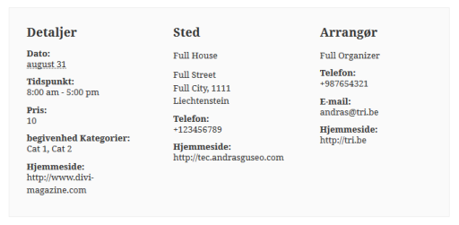

    Cloudup kw1ww2cmcjf
    Since you have a couple more strings in the event detail section, I suspect that those come from the theme. If this is the case, then check the translation files of the theme, possibly you will need to translate them there. (These are the strings: Cost, Venue name, Organizer name.)
    To check whether it comes from the theme, you just need to switch back to a default theme like twentysixteen. If the string Cost is translated there to Pris, then the translations are working and you will need to check the theme.
