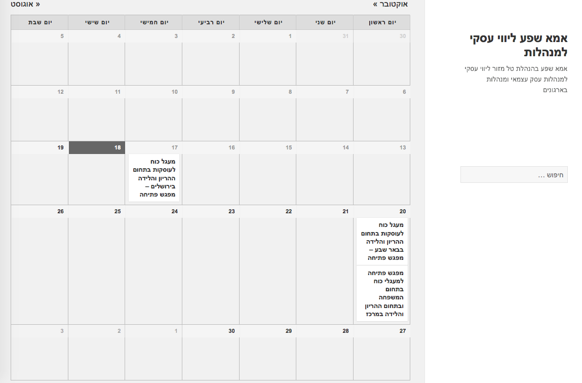

    Im working on a rtl template, and on the main events, the tool tip shows the php code instead of the information

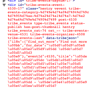

    The code being displayed in the tooltips is JavaScript, and when I viewed the source of your site it seems that this JavaScript code, instead of running, is being converted into character entity code and so it just displays like text in the tooltip.

    Ive made a copy of this website in another hosting, and changed the theme for twenty fifteen
    this is a regular website no rtl code:
    http://www.test.digital-design.co.il/eventss/
    still, the same problem

    Thank you for doing that! I found the URL that you linked to still had RTL code, as shown in this screenshot:
    The problem persists. For example, when I look at the HTML source code for your tooltips, it seems like whatever is enabling RTL on your site (or possible something else) is messing up the encoding of parts of the HTML document itself:
    cldup.com/mo2jA2McUN-1200x1200.png
