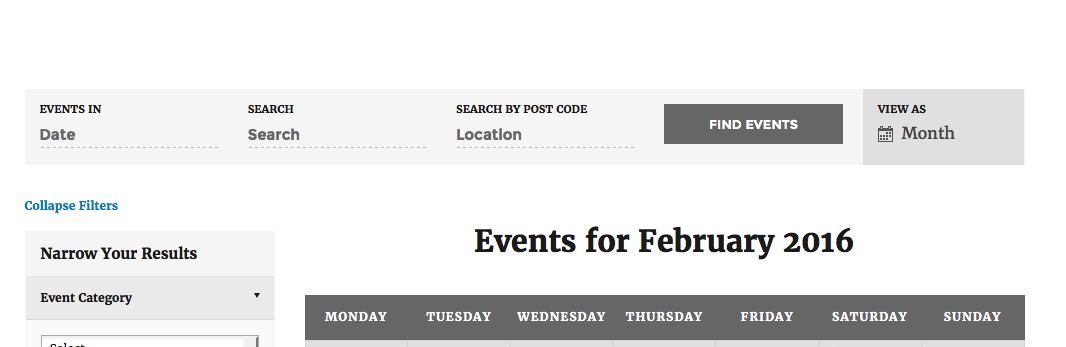

    A true PHP solution would be better, but this above snippet should do the job for now until we are able to provide a simple filter or something here. Here’s an example of the above code snippet working well and changing that label text:
    I hope this code snippet helps!
