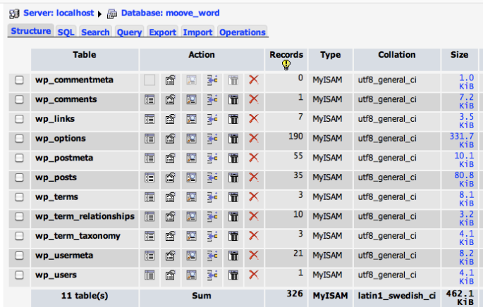

Would you mind logging into your hosts Database Manager, which should be PHPMyAdmin? From there, could you take a screenshot of your database tables, and include the Records and Size columns in it? Then share the screenshot here.
I am interested in particular to see if the wp_options table is unusually large. Usually it is the fastest table in the database, and yet in your logs it was one of the slowest. Here is an example screenshot of what I’m looking for:
