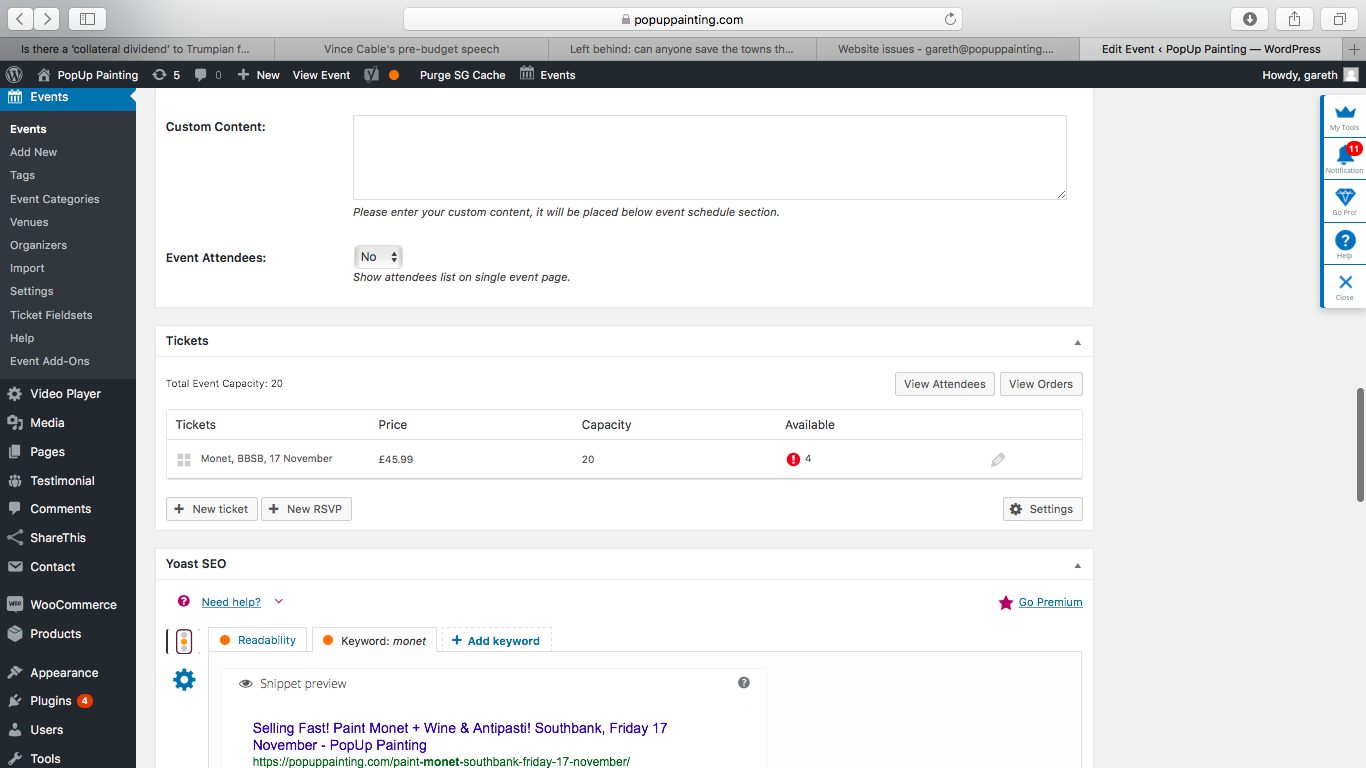

    Thanks for re-sharing the screenshots!
    The scenario is becoming difficult to test as your event has passed already.
    However, on this screenshot of yours I noticed the red exclamation mark. If you hover over it you will see a notification which will point out a discrepancy between the capacity of the ticket and the stock of the WooCommerce product. In these cases you need to go to the WooCommerce product page and adjust the inventory accordingly.
    This can happen when using different capacities (global, individual) for tickets, or when tickets are moved or deleted.
    Once you adjust the inventory of the WooCommerce product the exclamation mark will disappear and all should be back to normal.
    You should be able to still try it with this event. To do that best would be setting up a staging site (making a copy of the current one) and moving the event to a later date so the tickets still show up.
    If you don’t mind you can also do it on the live site and set the event to private. This way only logged in users will be able to see the event.
    Creating a backup before any testing or major changes is always recommended.
    Please let me know how I can help you further.
