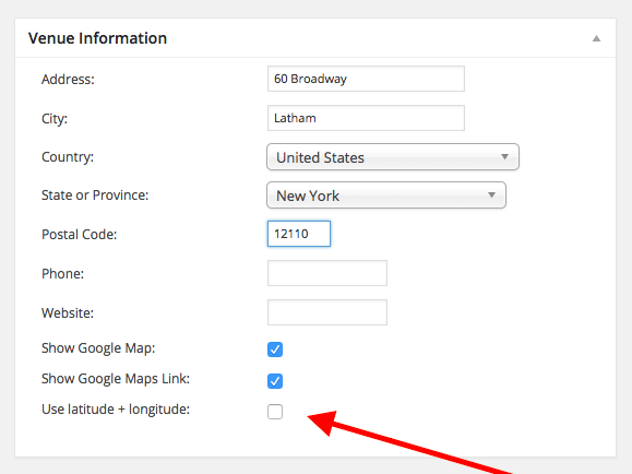

For example, if you head to a single venue in your wp-admin, make sure its “Use Latitude + Longitude” option is checked, which is shown in this screenshot for reference:
For any given venue that currently doesn’t show up, I would recommend the following steps:
1. View this venue in your wp-admin.
2. If the Latitude + Longitude option is not checked, check it.
3. Save the Venue.
4. Try searching again.
If the option is checked, then try un-checking it and save the venue. Then do steps 1-4 above on it again. This may get things to “refresh” correctly and may make a difference.
