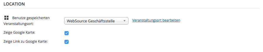

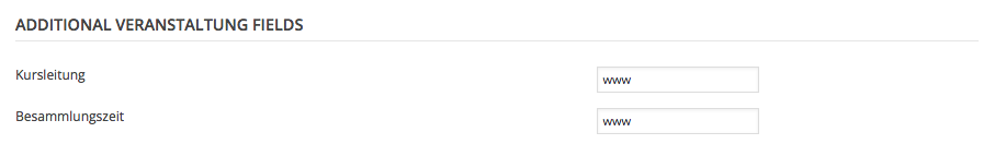

https://theeventscalendar.com/content/uploads/2016/08/ce9f16ae5287698b.png
and
https://theeventscalendar.com/content/uploads/2016/08/e67de920e6e007b8.pngstill not translated – no open string at translations.theeventscalendar.com

https://theeventscalendar.com/content/uploads/2016/08/ce9f16ae5287698b.png &
https://theeventscalendar.com/content/uploads/2016/08/e67de920e6e007b8.pngare still not translatable.

The first string “Location” was a tricky one, but I found it and is already pending merge into our next release, so that will be translatable within a couple of weeks.
The second string “Additional Veranstaltung Fields” can actually be translated, only the .po files for Events Calendar Pro need to be update from the .pot.
- open the tribe-events-calendar-pro.pot file and check if the string “Additional %s Fields” exists. If not, then run an “Update from sources” in PoEdit. Then save and close.
- Open tribe-events-calendar-pro-de_DE.po and run an “Update from POT file …”. Now the string should be added to the .po and you can translate it. Save and upload to wp-content/languages/plugins and you should be set.
Please check this last one and let us know if this helps.

Thanks Location works fine. However after the Update “Additional Veranstaltung Fields” is still not in the .po file
