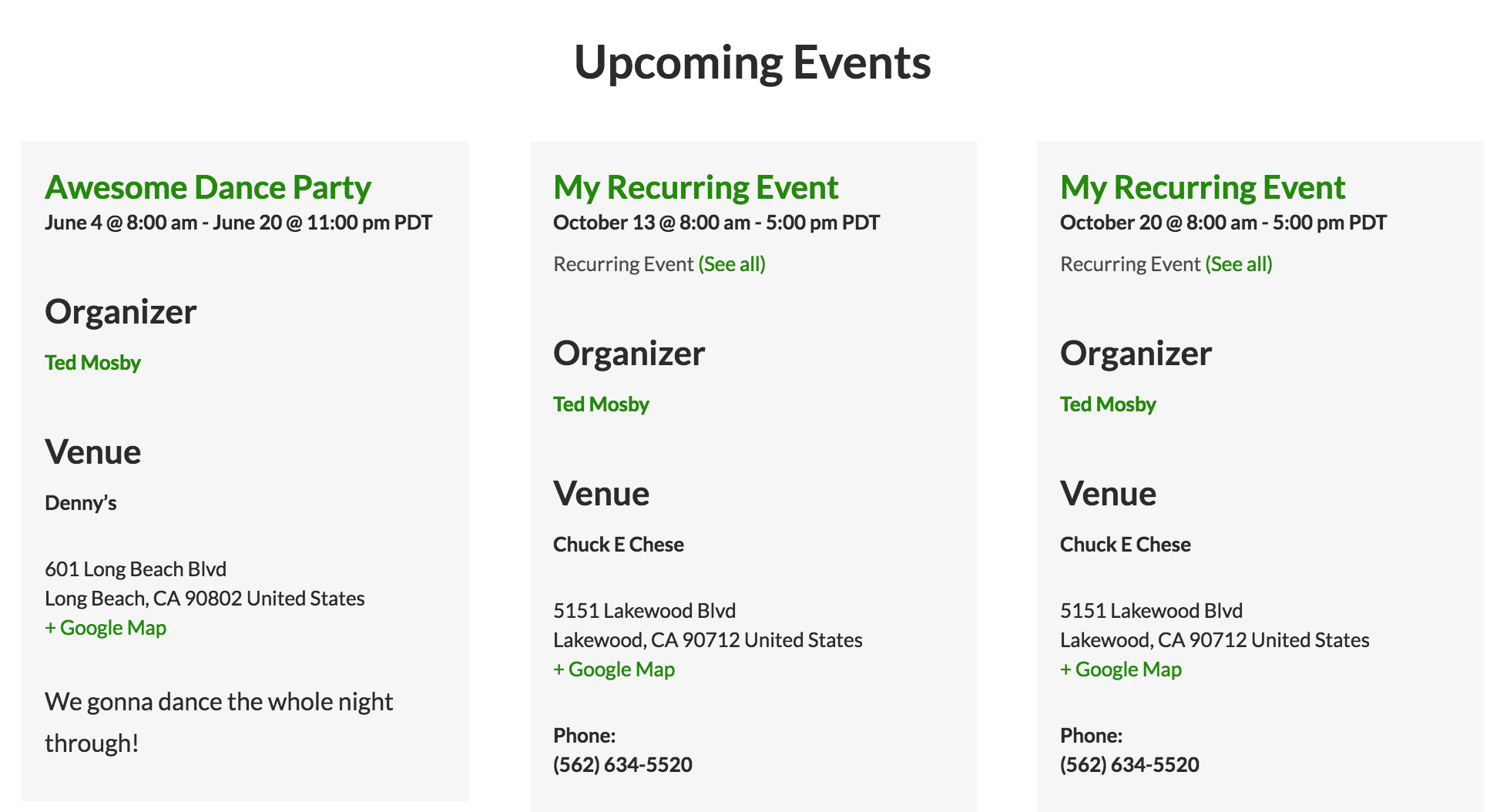

    Shannon, I hope this code snippet is beneficial to you:
    https://gist.github.com/cliffordp/69e9440d344e923c8f326b7ed846b04f
    Here’s a GIF preview of the result on Twenty Sixteen: http://cl.ly/0R2r0Q0F0L03

    Hi. Here’s a GIF of that snippet in effect on TwentyFourteen: http://cl.ly/1i2r412X2N1q

    As it stands, you contacted us asking about a detail in the calendar and how to get it to appear. That detail–regardless of whether it was ever available in a previous version–is accomplishable using the method Cliff provided. That method has been vetted by others on the team and has been tested by me personally. Here is a screenshot of the change once I’ve added it to my local installation of WordPress using only the Twenty  Fourteen theme.
    Note the “Organizer” and the “Venue” sections. These are the details that Cliff’s code adds to the template.
    Just to confirm: these are the details you want added to your template, correct? In other words, you want the Organizer and Venue details to show up in the event information when viewing the calendar in Photo View?

    The output of that hack, which doesnt work for me as I have already shown, is frankly quite ugly and looks nothing like details shown in any other view.
