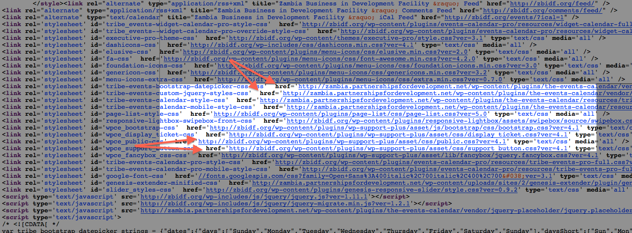

    Hey Maria,
    Thanks for your update here.
    I’ve been going over possible culprits here for a while – your patience means more than you think! – and I think I’ve boiled down the fundamental problem here:
    Basically that simple little JavaScript error is preventing things from functioning correctly on your page, even though I think most things about your site are indeed set-up correctly and should work mostly fine if this JavaScript error were to be resolved.
    But here’s the thing – the un-minified development JavaScript of our plugin is being loaded instead of the minified version, which is causing the random debug error and breaking other JavaScript-reliant elements on your page.
    I think the source of why this development script is being loaded is because of your domain mapping.
    Check out this screenshot, for example, of your page’s source code – note how some scripts are loaded from zbidf.org, while others (especially ones from The Events Calendar) are being loaded from zambia.partnershipsfordevelopment.net: https://cloudup.com/cWigPRVJJQy
    I think this is because, deep down in the inner workings of Events Calendar PRO, the following variables are used to generate the URLs to the resources folder – and the scripts within it:
    $this->pluginDir  = trailingslashit( basename( dirname( dirname( __FILE__ ) ) ) );
    $this->pluginPath = trailingslashit( dirname( dirname( __FILE__ ) ) );
    $this->pluginUrl  = plugins_url( $this->pluginDir );
    So maybe, despite aspects of the domain mapping that you have set up, the references to __FILE__ will bypass that and prevent the proper file being loaded.
