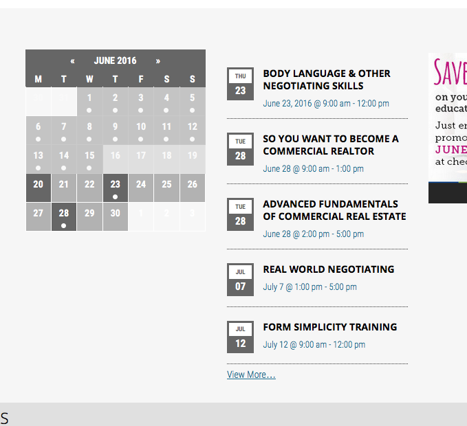

    Just thought of another way to prove that the issue with the event list showing up under the calendar image was working with limit=”0″ before the plugin update was done. Here’s a screenshot from InternetArchive.org of the home page from 6-1-16 https://web.archive.org/web/20160315113935/http://www.omcar.com/ and you will see the calendar has no events under it.

    #1 The Two-Column Display of Event Widgets
    You describe your goal as such:
    What I am wanting to achieve is in 2 columns. Column 1 just the mini_calendar image display with no calendar items listed below it =”0″.
    ☝️ To achieve this, you must add custom CSS on your site like the following:
    body.home .tribe-mini-calendar-wrapper:first-of-type div.tribe-mini-calendar-list-wrapper {
    display: none !important;
    This how that makes things look on your site:

    The css fixed the issue on the home page so thank you for that. My only question is why was this necessary now and not in the past, because as I showed you it was working without that code prior to the recent plugin update.
