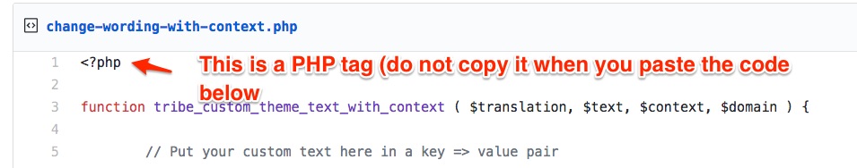

    we are running our page on wordpress.de \ business – where do I find those php tags etc. I cannot find anything 🙁
    #1345270
    Good evening Alexander,
    Thank you for writing back.
    The PHP tag I was referring to can be seen here (and in most PHP-based snippets): https://gist.github.com/andrasguseo/29903a974cb84060957881c17613c278
