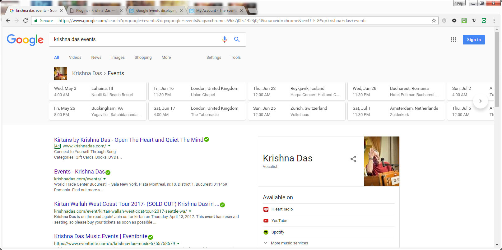

    Google Events is successfully picking up the event information, but the information is not accurate. Sometimes the location is not correct, and other times the time is not correct.
    Is there a way to ensure that the information is accurate in Google, or any way to re-sync it?

    It appears that ALL of the Google Events are 4 hours off, regardless of their location, and the location of the google user.
    We have tried it with timezone mode enabled and disabled, and it does not appear to make a difference.
    Please advise.

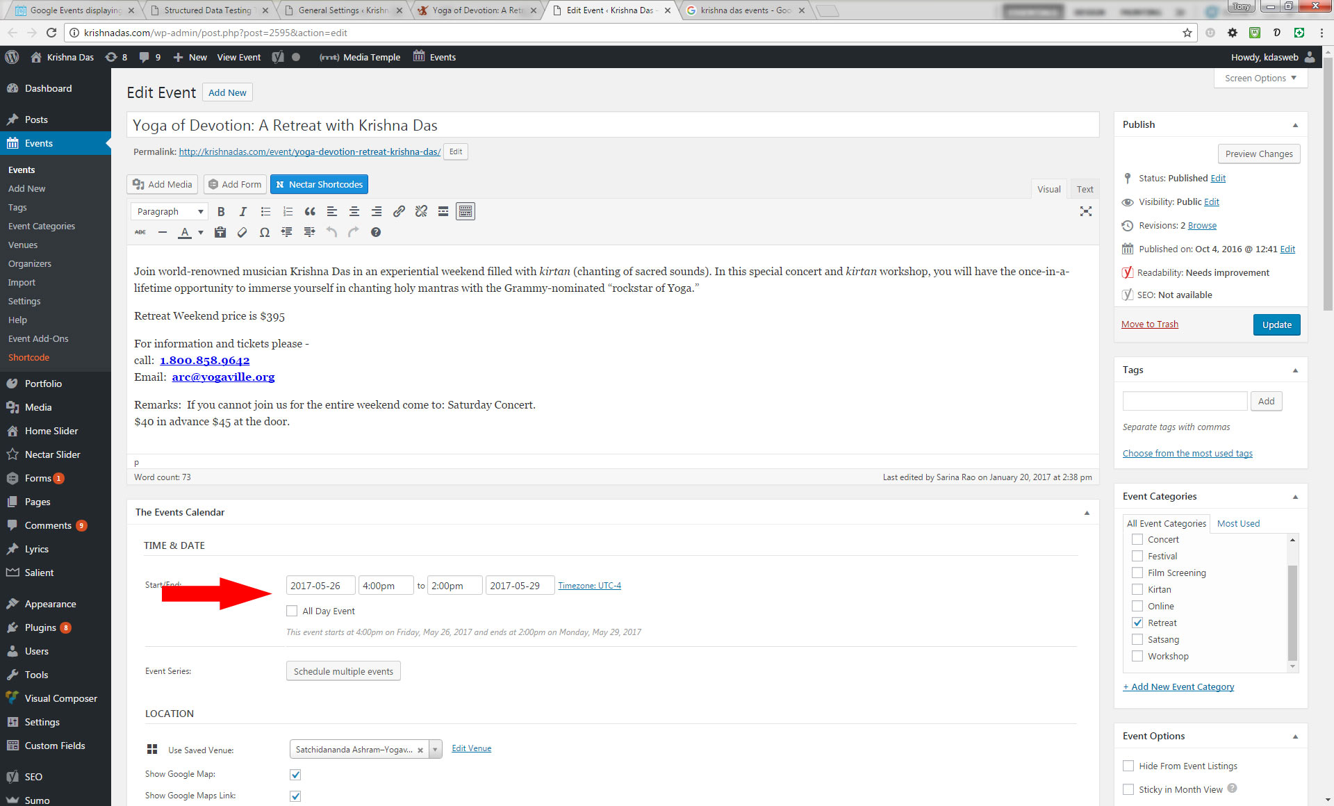

    Please also provide a screenshot of this event’s wp-admin event edit screen so I can see its date and time settings.
    Thank you.

    I ran one thru the structured data test. It appears that is showing the wrong time, just like the Google results. Screenshots below.
    Thanks again for your help. We have had many people showing up to events at the wrong time.

    I see your timezone is not set in WordPress settings and instead you set a manual UTC offset.
    Since you’re in Virginia, I’d suggest going to wp-admin > Settings > General > and set your timezone to New York.
    First, you could try changing this event’s timezone to New York and see if that helps any. (Of course, make sure to clear your site’s cache before re-testing in Google’s tool.)
    To the possibility of there being a bug here, though, I see that the JSON-LD at http://krishnadas.com/event/yoga-devotion-retreat-krishna-das/ is https://cl.ly/3X0a1k3U3b35
    In other words, it doesn’t have a specified timezone, like my testing site does (set to Chicago timezone but converted to UTC+00:00): https://cl.ly/2O0N1I1Y3u0Z
    So both your site and my site are displaying in UTC time, but your site doesn’t have “+00:00” at the end of the time. I’ll log this bug, as I was able to reproduce the issue on my testing site.

    Regardless, this specific event has a timezone of UTC-4:
    Please change this event’s timezone from UTC-4 to New York timezone and see if it fixes it in Google’s testing tool.

    I just updated the individual event:
    Yoga of Devotion: A Retreat with Krishna Das
    emptyied my cache, and ran it thru the Google tool:
    https://search.google.com/structured-data/testing-tool/#url=http%3A%2F%2Fkrishnadas.com%2Fevent%2Fyoga-devotion-retreat-krishna-das
    The same issue appears to be happening.

    I see your event is now displaying with the correct JSON-LD: https://cl.ly/042p3W3e2R3f
    And the testing tool detected this as well: https://cl.ly/2U3q1Z231N2K

    The fact that your event starts at 4PM New York time means the screenshot I shared of 8PM is accurate because it is 8PM UTC:
    “startDate”:”2017-05-26T20:00:00+00:00″,”endDate”:”2017-05-29T18:00:00+00:00″
    The “+00:00” means UTC time.
