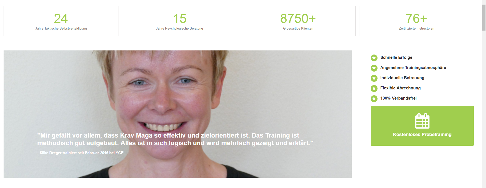

    we are encountering fatal errors on our site. After investigation it really looks like the event calendar plugin in the bad guy.
    Earlier today someone got this error message when visiting our site:
    2016/07/07 01:24:03 [error] 1981#0: *784505 FastCGI sent in stderr: “PHP message: PHP Fatal error: Call to undefined function tribe_is_week() in /var/www/vhosts/you-can-fight.com/httpdocs/wp-content/themes/Avada/functions.php on line 261” while reading response header from upstream, client: 5.189.131.55, server: you-can-fight.com, request: “GET / HTTP/1.1”, upstream: “fastcgi://unix:///var/www/vhosts/system/you-can-fight.com/php-fpm.sock:”, host: “www.you-can-fight.com”
    Our admins work around a little bit.
    The site now shows up again.
    However, all internal links on the homepage do not work any more. You’ll always be redirected to the homepage while you can see the correct links when hovering them.
    Plus, when activating the event calendar plugin, it crushes down part of our homepage.
    (please see attached pic)
    Can you please help asap.

    To clarify:
    The error message mentioned above does not show up any longer. It showed up yesterday morning when we first were informed about the error by one of our clients.
    When we now activate the events calendar plugin and the events calendar pro plugin, the only thing that changes is that the content on our homepage is crushed.
    Please see before and after pics attached.
    Most concerning is that no links on our homepage work anymore.
    What to do?

    I see your alert about the design issue on the site, but it is rendering perfectly for me. No squashing occurring, the site is full-width.Capture
    What web browser/device are you seeing this “squashing” in? It seems probable that is limited to only certain web browser.
    – Brook
    #1138538
    Chris
    Hi Brook,
    yeah, it seems to be fixed at this time because of Ryan’s intervention.
    Here’s what he wrote.
    Hmm, that’s strange. The page template is assigning both the 100% width and the dual sidebar classes. I can’t see anything that would cause both of these to be assigned, but I went ahead and added some custom CSS to ensure that the 100% width styling is applied to that class. Can you please confirm that it’s working on your end for me?
    So it looks like we are done for the moment. Hope this will not occur again after any update of the theme or the plugin.

    Chris
    HeyRyan,
    Hey Brook,
    I’m sorry, it does not work that way.
    Just look at
    https://www.you-can-fight.com/tickets-cologne/
    or
    https://www.you-can-fight.com/kravmaga/krav-maga-koeln-zollstock/
    these sites are still crunched.
    We’d really prefer a clean solution without code fumbling all the time.
    #1139262
    Luke
    Hello!
    We are aware of this issue as a ticket was created with us for Avada. The good news is we have it fixed and it will be part of the next update.
    Cheers
    ThemeFusion
