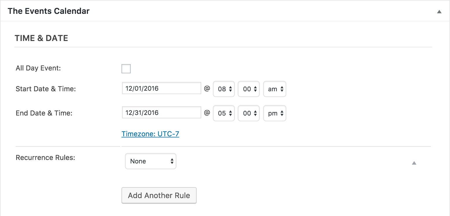

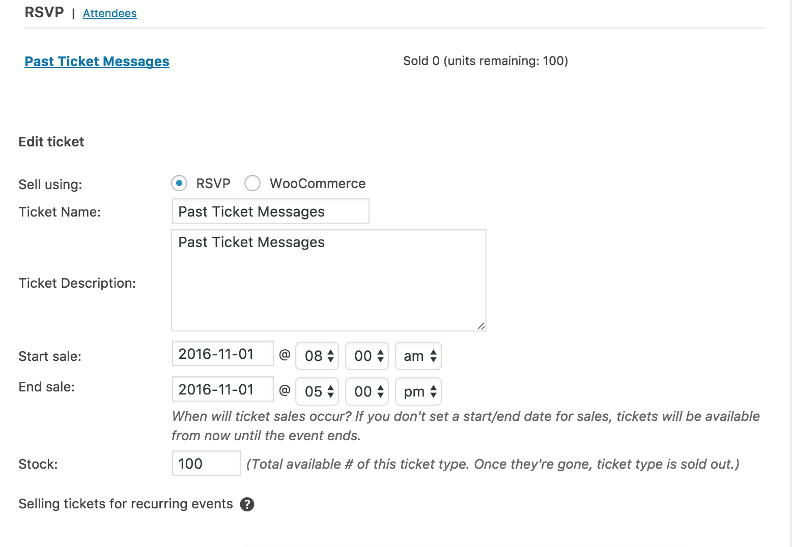

    I’ve attached screenshots of the dates for the ticket sales for a particular event so you can see it has passed but the event date has not.

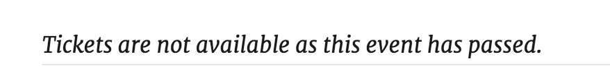

    You answered my question perfect! And thank you for sharing the screenshots, they actually helped answer my questions. I did experience the behavior where no notice is displaying for tickets that have not gone on sale yet, however I am getting a “Tickets are not available as this event has passed.” message when viewing an event with tickets that has already passed. (see screenshot below)
    From my understanding, it is the default behavior that the tickets not get displayed until the ticket sale start date has been reached. And we did have a bug open for the past event ticket messages, but that has been completed and it appears to be working as designed for me.

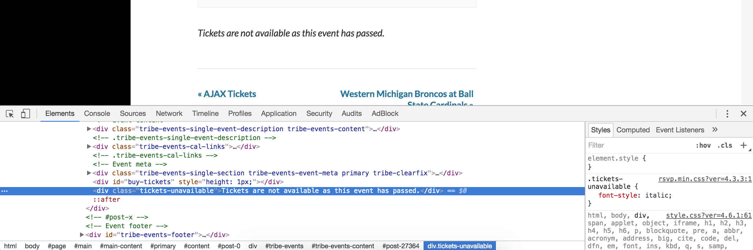

    I just spun up our test server again and I did everything AGAIN to test for conflicts. With the default 2014 theme it will break the comments message too – screenshot below – so still nothing revealed there either. I even disabled Woocommerce to test to see if that makes a difference.

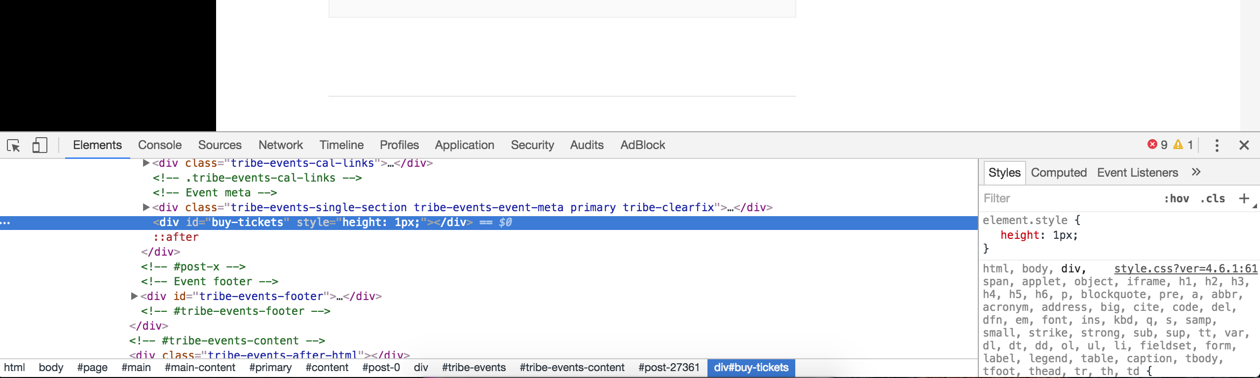

    I’m not getting ANY messages the tickets will display though when sales are active. I’m attaching screen shots I took today with the web inspector open to see if that helps allude to whats going on. I appreciate the assistance as its driving me crazy trying to figure out where this is breaking.

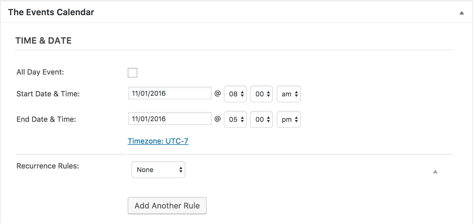

    Thank you for the response. Below is a screenshot of an event in the past with tickets.
    Below is a screenshot with of an event in the future with tickets that are not on sale yet.
    As previously mentioned, the behavior I’m experiencing is correct and was hashed out in the previous bug ticket you’re referring to. The messages based on ticket start sale and end sale dates appear to be working properly.
