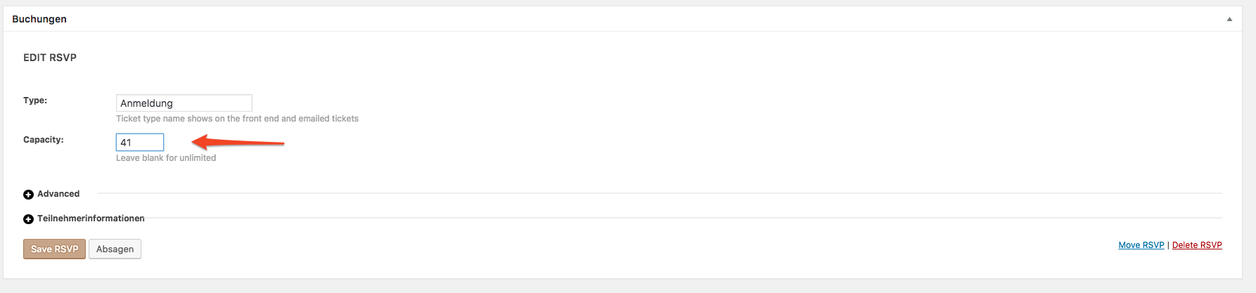

    Uwe Matern
    Hi Andras,
    we do not use shared capacity.
    I tested it again and documented with associated screenshots.
    1. Starting point – an event with capacity 40, 37 sold, Available 0
    2. shows the booking screen – still 3 available
    3. edit the capacity – plus 1
    4. Result – capacity increase by one = 41 – Available still 0 🙁
