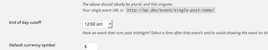

    Next, I’m wondering if you find any progress by heading to Events → Settings in your wp-admin and pushing the “End of Day cutoff” option ahead a few hours? Here’s the specific option I am referring to:
    <a href="http://” target=”_blank” />
    Try pushing it ahead 2 hours, see if anything improves; if not, then 4 hours and see if anything improves; does any sort of progress arise from this testing?
    Your patience means a lot and I am genuinely sorry about all of the trouble here. I’ve been working to try and isolate the culprit, but it’s been a tricky problem to nail down.
