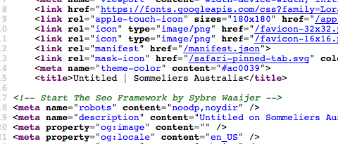

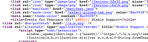

    As for the empty HTML page title, I cannot recreate this. Here’s the title in the source code of your month view page, showing “Untitled” (click for a larger-sized image):
    Here’s the title in the source code of my month view page, showing the month name and site title (click for a larger-sized image):
    ☝️ I am using your theme and the BreadcrumbNavXT plugins just like your site, so not sure what is happening here. You may find it useful to try the complete set of troubleshooting steps on this page → https://theeventscalendar.com/knowledgebase/testing-for-conflicts/ After EACH STEP in that process, check back on your month view and see if the document title changes at all.
