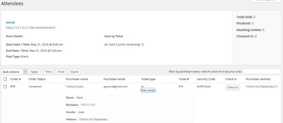

    You can try this in the Attendees_Table.php file to get an extra column with the address in the backend.:
    1. In the “public function get_columns() {” function add a column name like
    'purchaser_address'  => "Purchaser address",
    2. Create a function for displaying the address:
    public function column_purchaser_address( $item ) {
    echo get_post_meta( $item[order_id], '_billing_address_1', true );
    Here the function name has to match the column name above like:
    public function column_{column_name}( $item )
    Let me know if this gets you started.
    #1118121
    Roger Klein
    Hello Andras
    Thank you for your help – it worked!

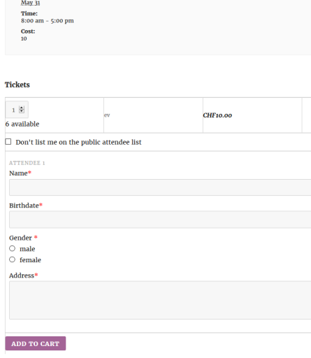

    #1118387
    Hey Roger,
    I might have an easy solution for you which actually doesn’t require any coding.
    When you create a ticket you can also create a fieldset. Just check the box “Request information for each attendee during registration”. This will open a simple form builder, where you can add a (required) field to ask for the address. You can save this form so you can re-use it with one click for other tickets as well.
    Here are some screenshots:
    Cloudup izjstw40t5u
    Cloudup o33on1fkrzk
    Cloudup mmnhnx1lbbg
    Cloudup onoeu0ymqhl
    I believe this is a much more effective way to do it, without any coding.
    Please, let me know if this helps.

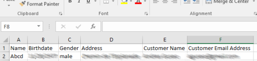

    #1118601
    Roger Klein
    Hi Andras
    Thank you so much for the solution you provided.
    I tried it and everything in the backend looks good except one little claim I have to mention regarding the export-table. The attendee addresses were successfully added to the export file but I need the customer address from woocommerce in addition to the attendee address. Unfortunately it’s not possible to also export the customer’s address on this way.
    The export file now looks as follows
    Attendee name, Attendee Address, Customer Name, Customer Email Address
    This is how it should look like
    Customer name, Customer Email Address, Customer Address, Customer Postal, Customer City, Attendee Name, Attendee Address
    I will defninitely use this field function
    Thank you
    Roger
