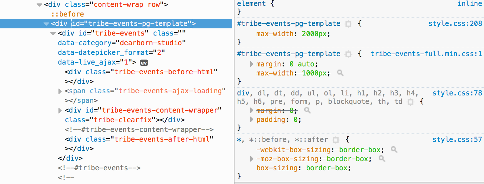

    This partially worked. It expanded the size of the calendar in IE, FF, and Opera:
    However, in Chrome, the view is still locked at the smaller width dimensions:

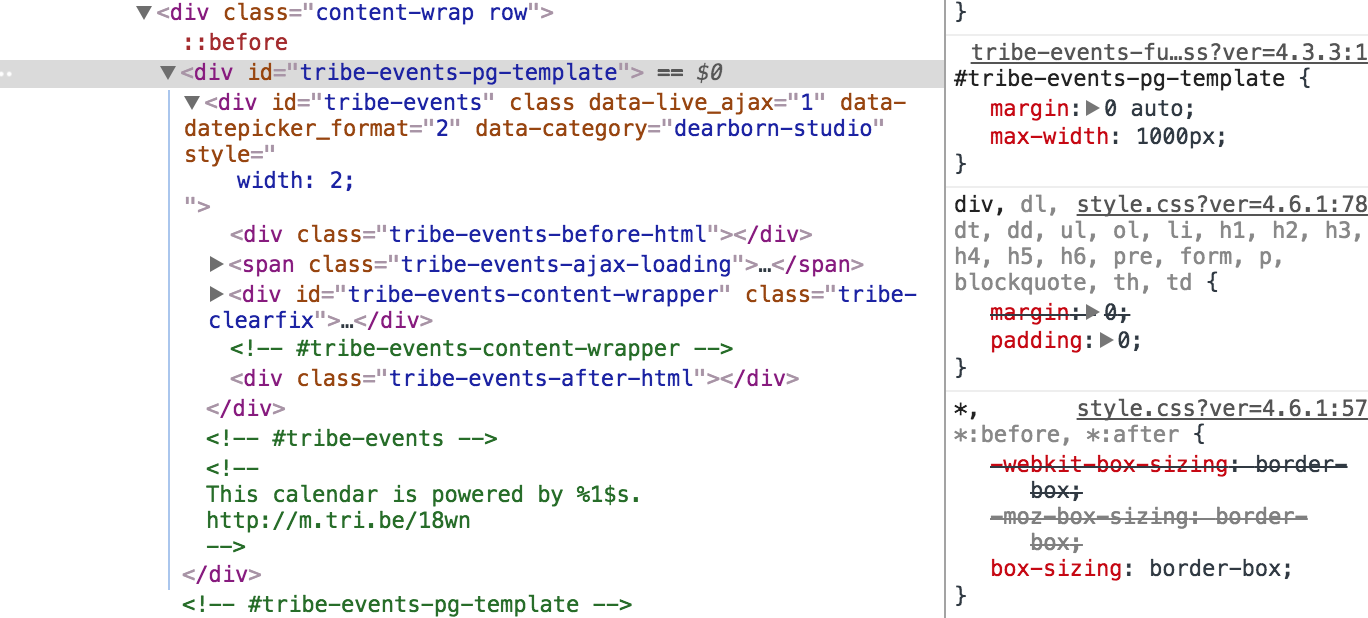

    I see that DevTools picks it up:
    screen-shot-2016-11-22-at-7-07-35-am
    …but Chrome’s does not:
    screen-shot-2016-11-22-at-7-08-23-am
    It’s not so much that the snippet doesn’t work, but likely more that there is something with how CSS is served by your site that is preventing it from working the same on all browsers. One other method you might consider is using the Simple Custom CSS plugin to enter the snippet instead.
