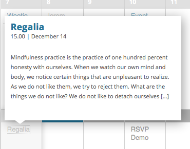

    #1041176
    christoffer
    Sry to say, it is not working, check image here http://imgur.com/nujZ3B6

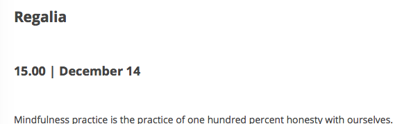

    #1041706
    I’m sorry @Christoffer πŸ™
    The nature of customization projects are all the site-specific things like this, because this code works well for me. For example, see these images as proof:
    I’m sorry that this solution doesn’t work for you as well – I’m not sure why πŸ™ Your best bet would be to explore the custom coding from here, and/or hire a developer to help, but in either case you’ll have to take the reins from here.
    I’m sorry @Christoffer!
    β€” George
