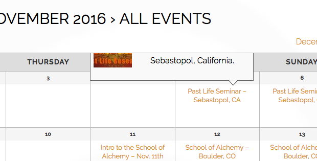

    I have the page set up in a list for the client at present, so you will need to ‘View As” month and go to November to see the problem. All of the events in November that are on the first two lines (top two weeks weeks) in monthly view are cut off at the top when they pop up. It is like they are being hidden under the header row on the calendar. The lower ones (last two weeks on the monthly view) are showing up fine

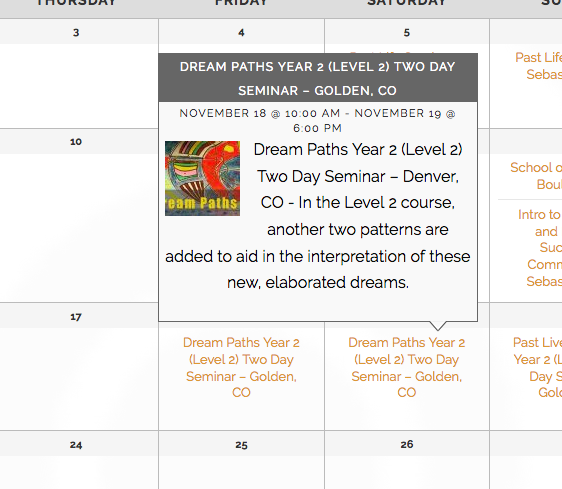

    1. The font size in the month view tooltips is too large, as shown in this screenshot → https://cldup.com/Nuh2hOILiD.png
    2. Tooltips for events in the first two weeks of the month view are cut off, as shown in this screenshot → https://cldup.com/AqAY4R8exv.png

    Hi George, The Archive is fixed … that is not a problem. The text size is controlled at this moment by the Paragraph setting in the typography of the theme … but even when I change this to 10 or 12 (which sadly affects everything in the site) I still have these top tooltips that are covered partially by the header of the Monthly Calendar …
    Just above the gray bar, where the Month appears disappears. The tooltip popup is hidden in this area regardless of the type size. I would so appreciate any CSS that you might suggest that will fix this.
    This is the only issue I have with the calendar, again … the rest is great!
    Thank you so much, Jan
    #1174607
    Thanks for clarifying things here, Janet.
    Does anything improve if you add CSS like the following to the bottom of your theme’s style.css file?
    body.post-type-archive-tribe_events .mk-header {
    z-index: 1 !important;
    .tribe-events-calendar {
    overflow: visible !important;
    Let me know! 😀
    #1174697
    Janet
    Guest
    Thank you so much !!!! That was the problem and it is solved. I will tell the client when I see them later this week.
