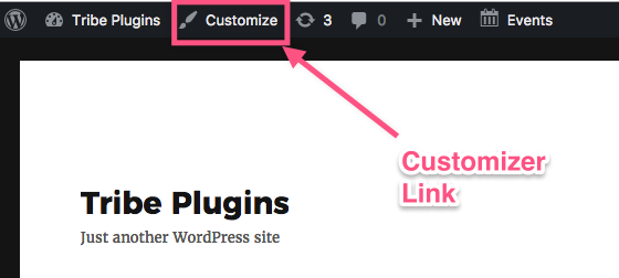

    If you don’t already have a custom CSS file you can use the Additional CSS field in the WordPress Customizer. You can find the link to the WordPress Customizer in the admin bar when you are logged into your site. The Additional CSS field at the bottom of the panel.
    See the following screenshot for reference:
    Does this help answer your question? Let me know how it goes!
