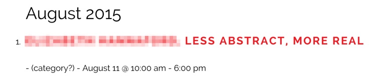

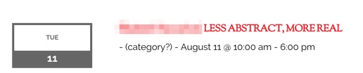

    #988669
    Ian
    OK all set up with a child theme functions.php with the divider code and this works just fine.
    What does not work is any of the styling etc. Instead of
    styled
    I am getting
    unstyled
    (note the echo of plain text where the tribe_meta_event_category_name() function is failing)

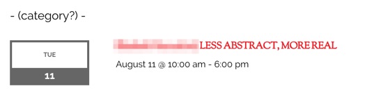

    #988684
    Ian
    OK – APOLOGIES – I have figured the styles oddity. I am using PRO and the path to the list-widget.php file given early on in this thread is from the standard version. Now I have located the correct file in the pro folders and started working with this things make more sense.
    Not working any better however!!
    The month divider code does not seem to work at all now and neither does the category display when inserted as follows (snippet only)
    <!-- Event  -->
    		<div class="<?php tribe_events_event_classes() ?>">
    			<?php echo tribe_meta_event_category_name(); ?> - (category?) -
    			<?php tribe_get_template_part( 'pro/widgets/modules/single-event', null, $instance ) ?>
    		</div><!-- .hentry .vevent -->
    A list entry currently looks like this:
    v3
    #988691
    Ian
    And now I have realised that in Pro the event itself is in a file under /modules/single-event.php
    I therefore put tribe_meta_event_category_name() in that instead but still only get:
    pro event
    #988701
    Oh man, I have led you down a bad rabbit trail–so sorry man! This is totally my bad.
    You are definitely correct that the pro/widgets/modules/single-event.php template is the way to go for the categories. Try using this instead where you would like the category to display:
    <?php echo tribe_get_event_categories() ?>
    Like I said, so sorry! I just tested that in my setup and it seemed to work well for outputting the category names for each event.
    Let’s tackle and confirm that first before moving on to the dividers. 🙂
