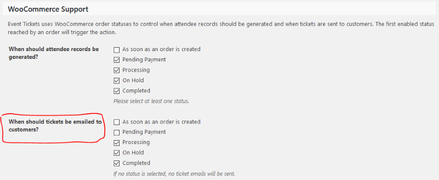

AndrasApril 3, 2017 at 6:36 am #1263352Ingo Storl
ParticipantHi András, thanks for your reply.
So I have changed the settings that you mentioned, didn’t realize that was now included.
In any case, the custom order status “zahlung erhalten” which translates to payments received doesn’t trigger the email. If I manually change the status in backend to “zahlung erhalten” nothing happens, only when order is completed “fertiggestellt” it sends out the emails, even though the settings are correct. See screenshot.
Having more issues with the ticketing and mixed carts (tickets and books in one cart) but I will post that in a separate thread one at a time.
Would appreciate some assistance with the order status and emails for now. what am I doing wrong? Thanks

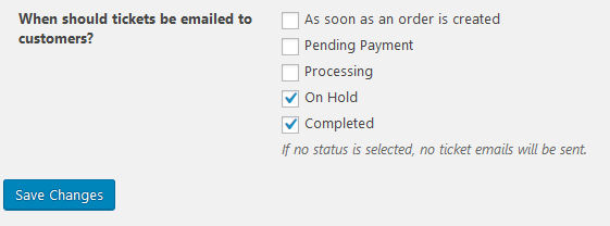

April 4, 2017 at 2:39 pm #1264418Andras
KeymasterHallo Ingo,
I checked my settings and it looks like this:
It looks like the “Zahlung erhalten” status is a custom status in your setup and that could cause the issue.
Can you confirm that is a custom status? If yes, please let me know how that was created / what are it’s settings. I will then try to re-create and test it.

Indeed I had a discussion on this with the team. Out of the box we support the built-in WooCommerce order statuses. Now if the plugin developer (Yith in this case) did their best, then it should work with their order statuses as well. You can test this via calling
wc_get_order_statuses(), and if the custom order status is among the results, then it should work. If it’s not there, then the order statuses created by that plugin will not work.Let me know if this helps.
