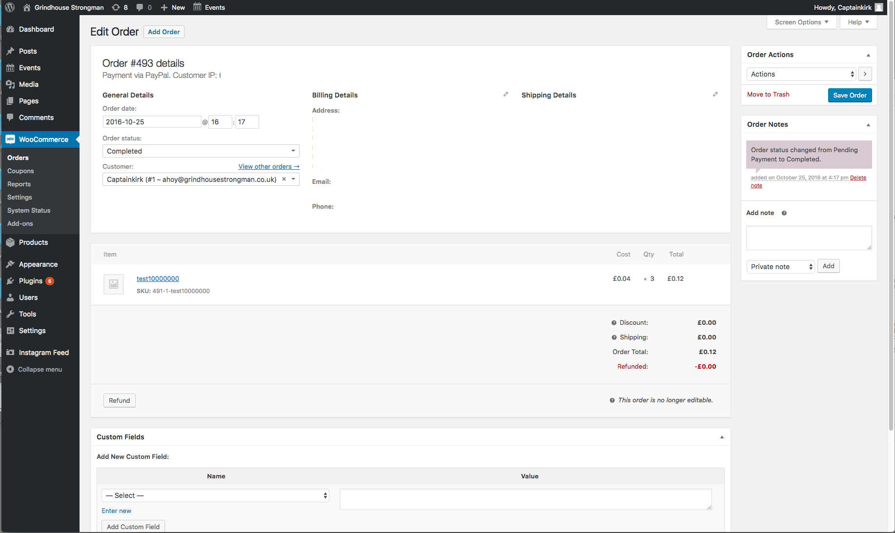

    Hello George, Thank you for the reply. I have updated to 4.3.1 and tested with Paypal Standard and still getting the same issue. I’ve attached screenshots. And also a screenshot of the order on the orders page (to show its completing ok, they are set to complete automatically)

    As you can see on the following screenshot the order completed ok.

    3. Can you also share a screenshot of the “Order notes” of the WooCommerce order itself? It’s the same as you did above with this screenshot that you previously shared.
