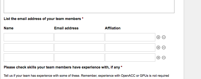

ParticipantNo worries @Brian! Thank you for updating things and for making that test page.
oddly enough, for me those + and – icons show up fine:
I am in Firefox on a Mac:
1. in what browsers and operating systems do you see this issue in?
2. And does using a different browser make any difference with the behavior of this issue?Thank you for your patience with this! 😀
