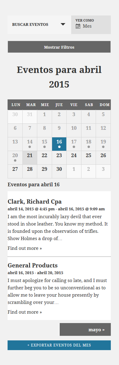

    Here is what I see in the Spanish Translation:
    tec-es_ES

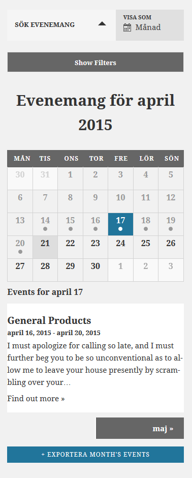

    Here is what I see in the Swedish:
    tec-sv_SE
    The only thing that is not working correctly is the “Find out more” in both, which I will be putting in a bug report to resolve.

    Yes, this is exactly the problem as I experience it. No matter what changes I make to the PO-file, the translation won’t go through.
    In addition to “Find out more” the words “Month’s events” in the blue iCAL button won’t translate. They should say “månadens event”.

    The iCal button is translating in Spanish so it looks again to be problem with the translation file.
