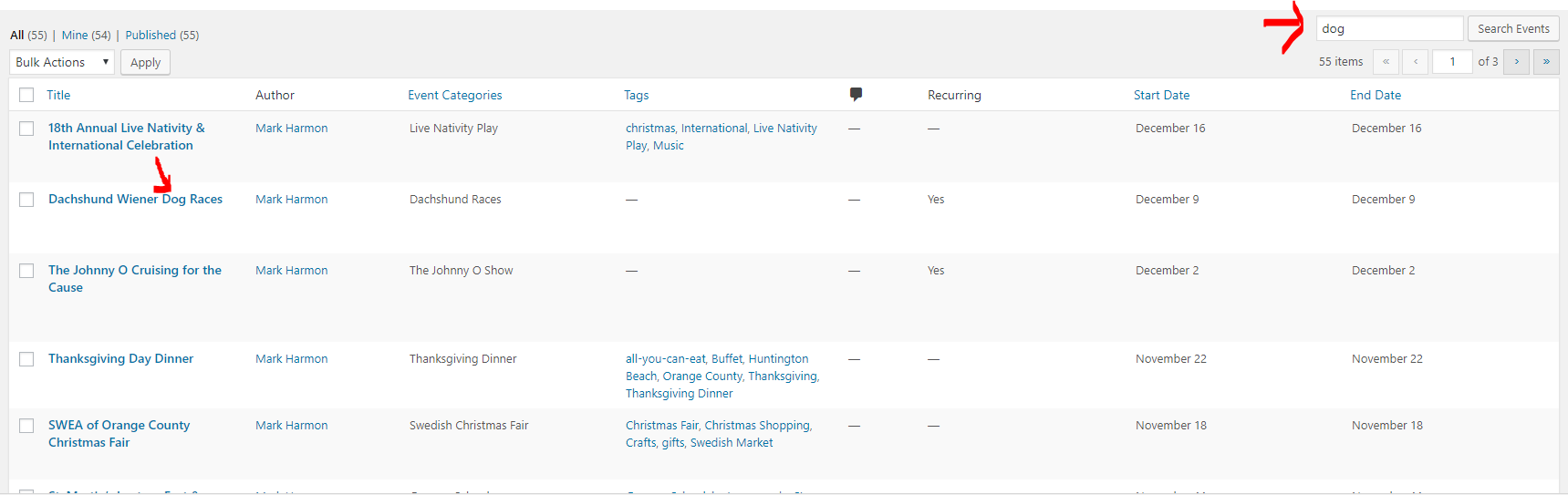

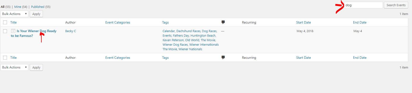

    Also, there seems to be a glitch when using the “Search Events” field in the Events view. See screenshot “dog search”. Whenever we type a search term, such as “Dog”, it’s not filtering correctly see screenshot “dog search 2”.

    I’m not quite sure I follow the problem you’re experiencing with search (as a sidenote, the filenames unfortunately aren’t preserved once uploaded to the help desk).
    It looks like you have at least one event that has “dog” in the title and after searching for this, the result set is reduced to just that event.
    That’s consistent with my own experience, but perhaps I’m misunderstanding?
