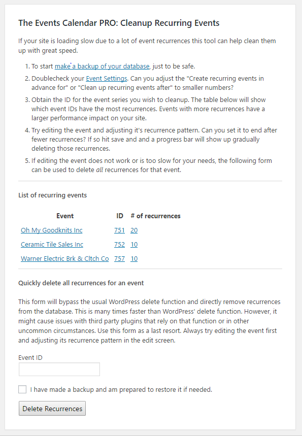

    To make this even easier, and remove the  need to worry about prefixes, I just wrote this cleanup tool: tribe-extension-recurring-cleanup-v0-1-0 It is a plugin you can download install on your website. Once activated you will see a new tool in WP Admin > Tools > Available Tools. It will show you a list of all of your current recurrences, sorted by those which have the most recurrences. It will also show you the ID for each.Follow the steps outlined in the tool to then delete all recurrences for that event. Here is an example of what the tool looks like:
    tool-ss
    Does that all make sense? Did that tool work for you? Please let me know.
    – Brook
    #1165315
    WOOHOO! It worked! Thanks so much!
