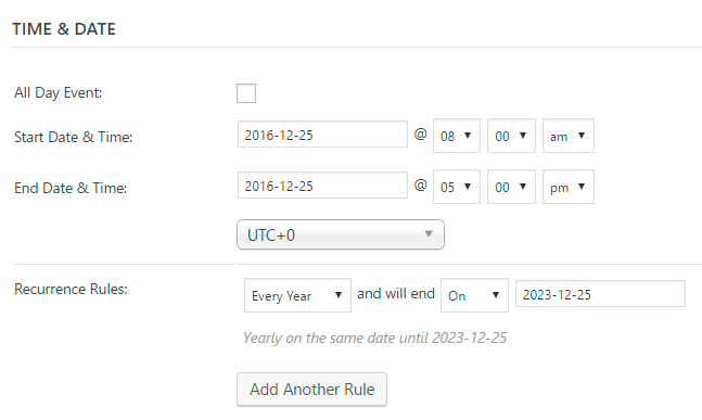

    I think the problem here is the end date of the event, let me explain. For example, let’s say I want to create a Xmas event that is taking place every year on December 25 the recurring settings for such event should be:
    x-mas
    Note in the example above the event end date should be the one for the first instance of the event. Not the one in which you want the recurrence to end!

    Thanks! I had End Date & Time set to the future, your configuration worked. My next question is, and let me know if you want this in a new thread, is there an easier way to choose a start date that is far older? The only way I see now is to keep going backwards with drop down, but that only allows 10 years at a time. Most of my start dates will be 1-2 hundred years ago 🙂
