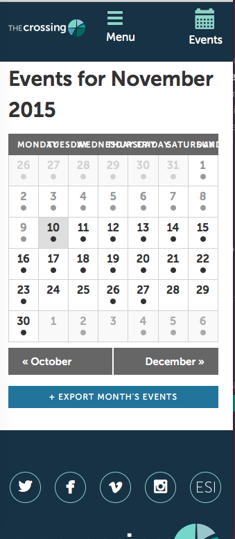

    Thanks for elaborating on this, and for your patience – one thing I’m still a bit confused by is the nature of your problems in the mobile view. In mobile view for me, everything renders fine:
    (The rest of the site footer renders and such, just not included in the screenshot).
    Do you find this to not be the case? If so, can you scare a screenshot of your mobile problems specifically?
    Thank you so much for your patience with this! Just trying to figure out exactly what you’re looking for so I can best be of help here! 😀
    #1023899
    Patrick Sasser
    I took out the code to add the wrapper. Notice now when you click on one of the dates on the mobile view it pops up the events for that date below the calendar…
    http://puu.sh/lgNAW/5e747bb477.png
    Make sense??
    So the stuff that says Women’s Bible Studies and Mizzou Faculty won’t ever load if the wrapper is in there.
    Thanks much,
    patrick
