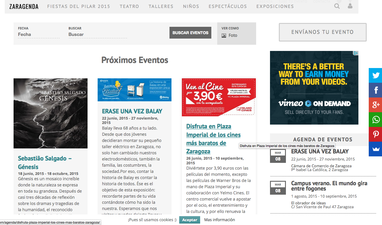

    Since the update, the sidebar goes down.
    How Can I solve this?

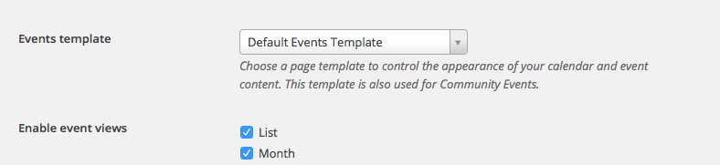

    Do you mean that the widget areas on the bottom of your site used to be up on the left or ride of the page?
    If so, then this is something that your theme dictates. We try to accommodate theme templates by allowing you set the template used for even pages.
    To change this, try heading to Events > Settings > Display in your wp-admin, and try different options for the “Events Template” option which I screenshotted here for reference:
    scrn
    Try all the options and see if any of them improve the layout on your page.

    Here’s how that makes things look for me on your site, for example:
    Try that out! I hope it helps ๐Ÿ™‚
