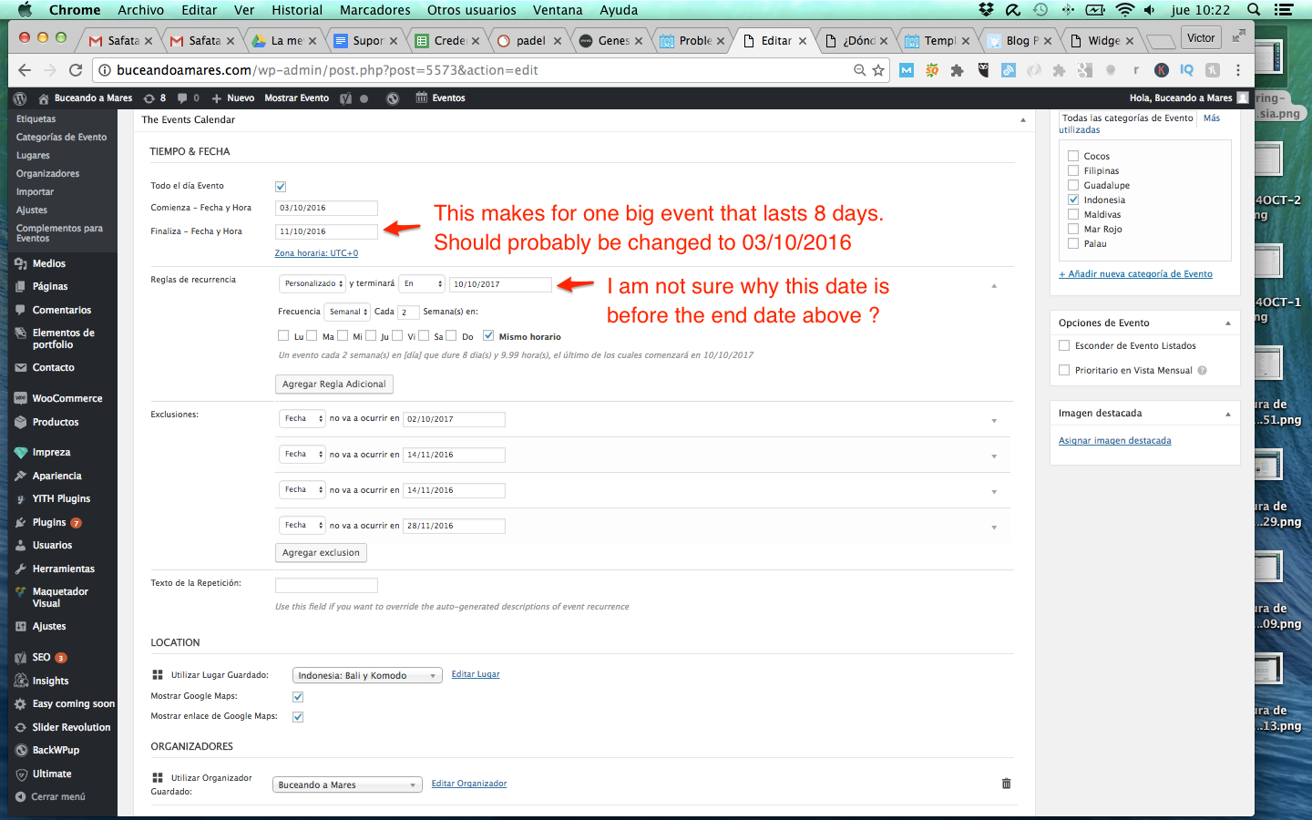

    The way you have defined this, you are trying to repeat one large 8 day long event (as opposed to 1 all-day event). You can see my corrected screenshot

    I don’t want a 1 day event, I want an 8 days event (they are like tour travels) and repeat every 2 weeks.
    So I think that the first part is correct, I want a big event that lasts 8 days.
    And the second date, if you notice, ends at 2017 and not in 2016 so it’s not before the above one as you say.
    Probably I’ve mistaken at doing the event recurrency but I think that your answer doesn’t help me in this way. I’ll take a look as soon as possible but if you can check it again it’ll be great.

    With that in mind, it enabled me to find a glitch with recurring events while using “all day” events.
    Simply put, at the current time, this does not work properly. The recurring events defined like that only span over 1 day (instead of 8). There is a bug ticket opened for that.
    Unfortunately, I cannot commit to a release date at this point. But stay tuned, you will be contacted when the fix is released.
    In the meantime (I have asked to see if it would be possible to get a temporary code snippet workaround), it looks like the only way to repeat events spanning over multiple days is to use a start time on the initial day of the multi-day event and an end time on its last day.
    Could you try that to see if it helps with the other issues ?
