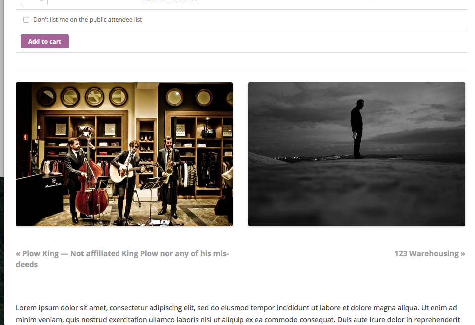

    Hey there,
    We unfortunately cannot help with code customizations, so you’ll have to take the reins on refining this, making iWe unfortunately cannot help with code customizationst work with your design, etc, but here’s an example of two snippets I wrote for you to achieve this ? https://git.io/voE7Q
    Here’s a screenshot of this to prove that it works:
    As noted, you’ll need to take the reins on further refinement, but I hope this helps!
    Your code is close, but the tricky thing with events is that the “previous” and “next” events only have these relationships to the “currently-viewed” event based on the time and date the event will occur. WordPress does not have support for events out-of-the-box (hence the existence of our plugins!), and is not built for that, so when you use its built-in features for getting adjacent posts, the relationship of “next” or “previous” is based on the date the post was published—quite different than the relationships of events!
    So, as you can see in the snippet I shared with you, some custom class methods within The Events Calendar need to be used here.
    Tinker around with it, and let me know if there’s anything else I can try to help with.

    darrienw93
    Hey George,
    Your snippet was perfect!!!
    Thank you very much for you quick help!
