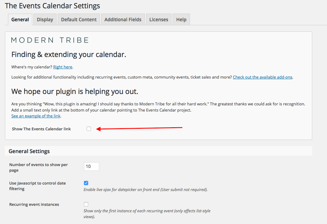

    1) how can I remove attached Calendar powered by The Events Calendar link? (Reference to below capture link)
    You should be able to do this by heading to Events > Settings in your wp-admin. There’s an option called “Show the The Events Calendar link” – simply un-check this option, save your changes, and it should be gone when you go back to view your page.
    Here’s a screenshot of that option:
