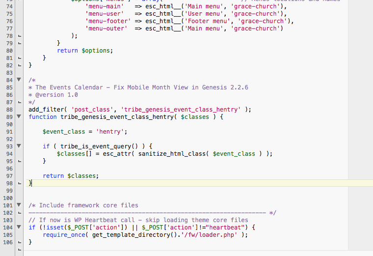

    #1053168
    Hi Emily,
    I believe I found the issue and this snippet added to your child theme’s functions.php will fix the issue.
    https://gist.github.com/jesseeproductions/0a4af5a83500f82af6ac
    This resolved the issue on my test site, let me know if that does it for you.

    #1064752
    Dillon
    Brian,
    I had the same issue and your code fixed the issue. Thank you!
    http://beyondthesights.us/events/
