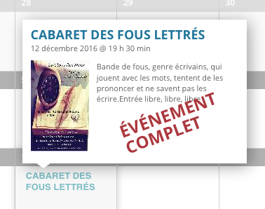

    3. Finally, on the link you provided in your second and private reply, I see the sort of custom HTML that you are describing:
    Is that big red text the text that doesn’t show if you make the change Josh recommended? If not, what text are you referring to?

    3. Yes, that “ÉVÉNEMENT COMPLET” is displayed when a showing is “complete”. That is the custom HTML I’m referring to. The case you show in the screenshot (december 12th) simply has this as its full content:
    <strong class="stamp">Événement complet</strong><img class="event-img" src="http://media.lavitrinesaguenay.com/image/1449666249573.jpg" alt="" align="left" /> Bande de fous, genre écrivains, qui jouent avec les mots, tentent de les prononcer et ne savent pas les écrire.
    Entrée libre, libre, libre
    You see the first “strong” bits at the begining is what I use to display the stamp-ish look in red. At the very end, if there is a boxoffice link (it would be parsed in during the XML generation process), it would be shown as such:
    <br /><strong>Admission :</strong> <a href="dummydomain.com/to/tickets" target="_blank" class="tribe-events-button">boxoffice link</a>
    Funny thing is that “a” HTML tag would display the standard button right in the hover, enabling people to purchase tickets via that url right away.
