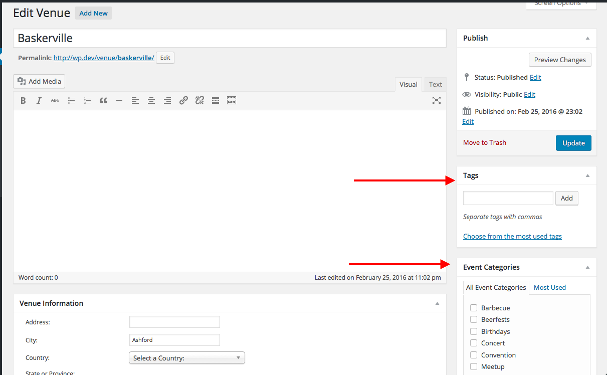

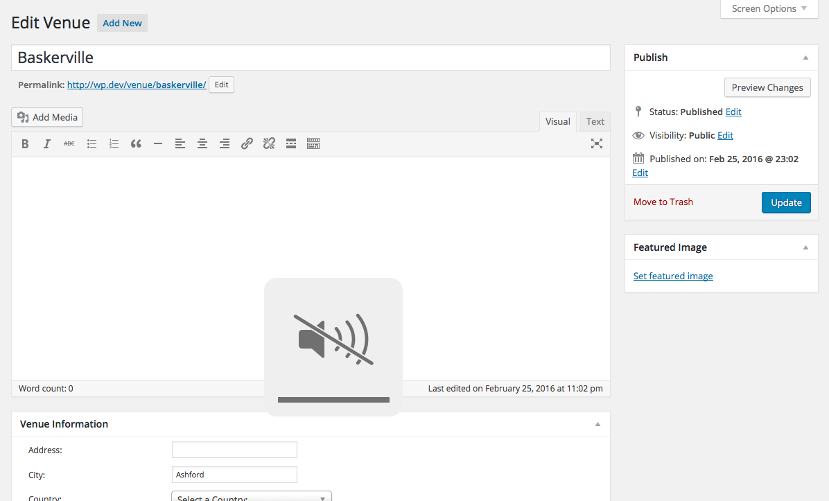

    To be clear, are you asking for how to make the default Venues view which looks like this:
    Have “event categories” and “tags” like this:
    If so, then yes, you can do this by adding the following snippet to your theme’s functions.php file:
    add_action( 'admin_init', 'add_taxonomies_to_venue_post_type' );
    function add_taxonomies_to_venue_post_type() {
    register_taxonomy_for_object_type( 'tribe_events_cat', 'tribe_venue' );
    register_taxonomy_for_object_type( 'post_tag', 'tribe_venue' );
    This is using the default WordPress function register_taxonomy_for_object_type(), which you can read more about here → http://codex.wordpress.org/Function_Reference/register_taxonomy_for_object_type
    I hope this helps!
