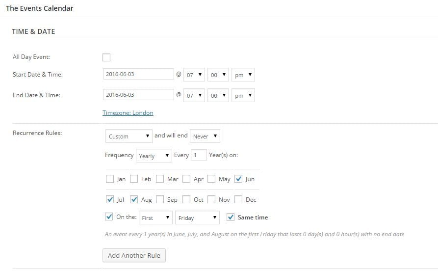

    2. When using a custom rule with the following; Custom, end = NEVER, Frequency = YEARLY, Month = one or more months, On the = TICKED, drop downs = FIRST FRIDAY, same as = TICKED and the event is then published. Initially, the event and all future events are correctly published, i.e. on first Friday. However, if the event is edited, for example change of title or main body and the update button clicked, then all future events are no long on the first Friday but on the particular day number of the month that the first event takes place on.
    To replicate set up the event as above, publish and check in calendar. Close the tab/browser. Open the calendar again, and edit the event title or body. Click update. Now all future entries are on the wrong day of the week. I happened to notice that when editing and event, the custom rule is not completely shown but missing some of the check boxes. The only way to see them is to select something else in the drop down, e.g. yearly and immediately change back to custom. It is then that you’ll notice the “on the” check box is no longer checked!

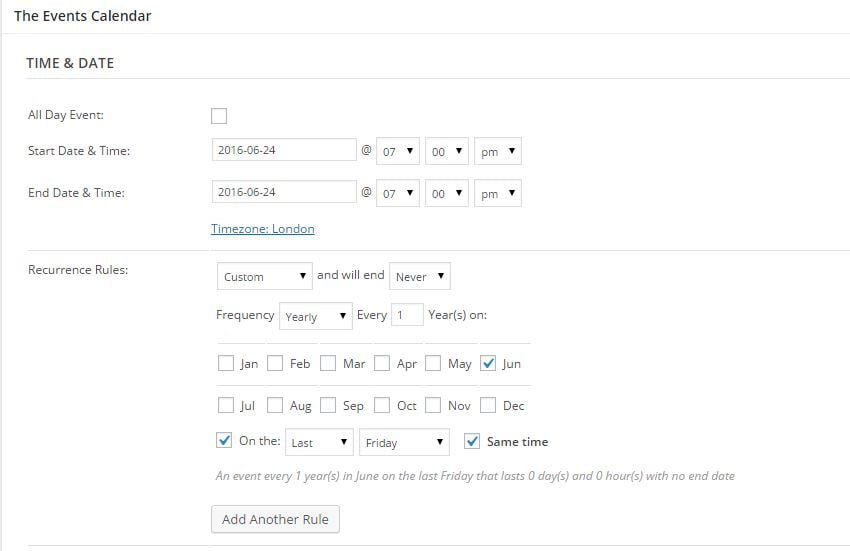

    My date picker was set to DD/MM/YYYY so I changed to YYYY/MM/DD as you suggested and to retested. I created a new event on Fri 24th June 2016 @ 7pm with custom yearly recurrence set to last Friday of the month (see Issue 1 screen shot below) with no end date. The initial event on Fri 24th June 2016 was created/displayed correctly however, the recurrence event was created on 19th May 2017 which is one month before it should be and it not the last Friday, it was also one Friday before it should be.
    Screen shots are here:
    Issue 1 – Last Friday of month recurrence settings

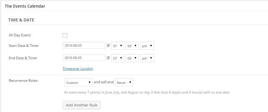

    Issue 2 – when creating the event BEFORE it is published
    Issue 2 – after the event has been published and editing it for some reason but BEFORE clicking the update button

    #1 – With the exact same settings as you show I’m getting the events generated correctly but the recurrence is not saving the ‘On the last Friday’ part of the setting. I’ve already log this bug in our backlog.
    #2 – I could reproduce as well, I’m seeing the same as #1, the ‘On the last Friday’ is not saved as well but events are generated properly. Note: to see the custom recurrence settings after saved/update you can toggle the rule visibility: https://cloudup.com/cLke8BQB5OK.

    I am experiencing a bug when toggling the visibility of saved events using the rule visibility: https://cloudup.com/cLke8BQB5OK. On a previously published event, when I toggle the visibility on, it has lost a previous setting “ON THE” is no longer ticked! No if I update the event, instead of the event taking place on e.g. the “First” “Friday” it is now shown on a particular day number of the month, e.g. day 5.
