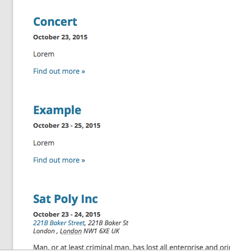

    This is an important post, because despite everything I said about customizations, I have gone ahead and written you a new function:

    Try replacing the code Geoff originally shared with you with that code above. It works well for me, here’s a screenshot of the effects of it which seem to be exactly what you’re looking for:

    #1017404
    Lara
    This worked! Thank you sooo very much! You should implement this option in your next update of the plugin so that no more people have this issue that seems to be fine in other sites. Thanks again!
