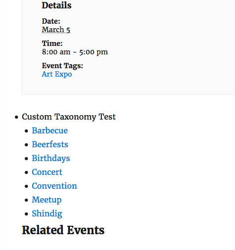

    To get the custom taxonomies to display as a linked list on single-events templates, you would need to customize The Events Calendar’s single-event template to include a custom call to load the taxonomies. You can learn how to do this here → https://theeventscalendar.com/knowledgebase/themers-guide/
    An even simpler approach would be to use the hook tribe_events_single_event_after_the_meta to add content after the single-event meta section (or tribe_events_single_event_before_the_meta to add content before the single-event meta section).
    You can then use the wp_list_categories() function to simply echo a list of taxonomy links, which you can learn more about here → https://codex.wordpress.org/Template_Tags/wp_list_categories
    If the custom taxonomy whose list of items you were echoing was called tribe_events_cat, for example, then you could put all of this code together to add something like this to your theme’s functions.php file:
    add_action( 'tribe_events_single_event_after_the_meta', 'tribe_custom_single_event_tax' );
    function tribe_custom_single_event_tax() {
    wp_list_categories( array(
    'title_li' => 'Custom Taxonomy Test',
    'taxonomy' => 'tribe_events_cat'
    Here’s a screenshot of how that looks:
    You’d have to take the reins from here to style it how you’d like and all of that, but I hope all of this helps.
