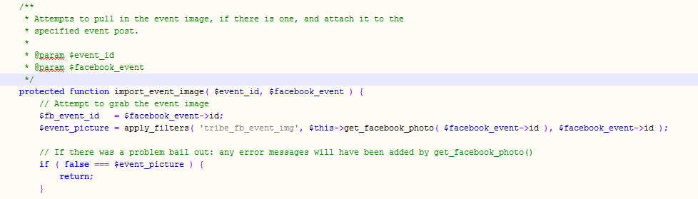

In this file:\wp-content\plugins\the-events-calendar-facebook-importer\the-events-calendar-facebook-importer.php
On line 756 change this:
$fb_event_id = $this->fb_object->id;to this:
$fb_event_id = $facebook_event->id;Changing that should fix the issue and I have tested on my own site and it is working for me.
Let me know if that helps.

This is how it should look:
