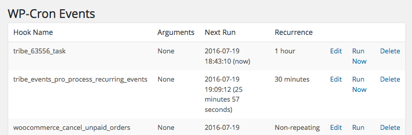

    One thing worth noting additionally is that you might have success by installing the free WordPress plugin WP Crontrol, which can be found here → https://wordpress.org/plugins/wp-crontrol/
    This plugin lets you manually run scheduled “WP Cron” events; the cleanup process in that helper plugin shared earlier is a WP Cron event, for example.
    So, once you install WP Crontrol, you can see the cleanup task like as shown in the top of the table in this screenshot:
    The task name to look for is tribe_63556_task. Click “Run”, but only ONCE at a time—do not click it a bunch of times in a row. And please do let it “work” for a few minutes. Check on the number of events after each time you click “Run”. If the number has decreased, then wait a few more minutes and click “Run” again.
    I know that this is still not a very ideal method for cleanup, but I hope it helps.

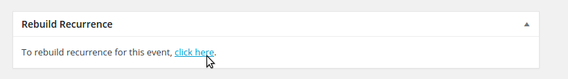

    What’s new about this version? Well, now when you go to any recurring event, you will see a metabox like this in the “edit event” screen for that event:
    ☝️ Unlike my Crontrol recommendation, this manual cleanup link should actually cause the cleanup process to run for the recurring event.
    Does this mean that there is still some manual processing you have to perform? Yes, unfortunately. But please note that the vast number of events on your site is not because of a lot of recurrence series—the previous bugs would just make these series never stop recreating, so even if you had, say, ten recurrence series, (which means you only have ten events to go to and click this “rebuild recurence” button on!), if each series produced 2,000 events erroneously then, boom, you have 20,000 events…in this example, you would go to the first event of each of the ten series and click the “rebuild recurrence”–you would NOT need to click that 20,000 times or anything like that. Perhaps this fact is obvious, but I just wanted to explicitly mention it in case it was a concern!
    I hope this helps—try it out and let us know!

    I installed and activated the plug-in after deleting the prior fix and I still don’t see the metabox you referenced.
    After 10 minutes, I am still getting this message:
    Recurring event data is still being generated for this event. Don’t worry, you can safely navigate away – the process will resume in a bit in the background.

    I waited several hours and was finally able to run the process using the metabox.
    After a few more hours, the events are only down to 18,808.

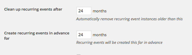

    ⚠️ Also, please note: I noticed that your site’s “Cleanup Recurring Events Before” option is set to 12 months, as is the “Cleanup Recurring Events After” option. This is a screenshot of the two options I am referring to:
    ☝️ If you compress these options to something like 3 months, for example, then it might increase the number of events cleaned up with the manual “cleanup event recurrence” link in the new cleanup plugin.
    I would recommend trying this and trying some more manual imports, and seeing how things behave. If you don’t want to, or do and don’t find much meaningful process, let me know and I can process a refund.
