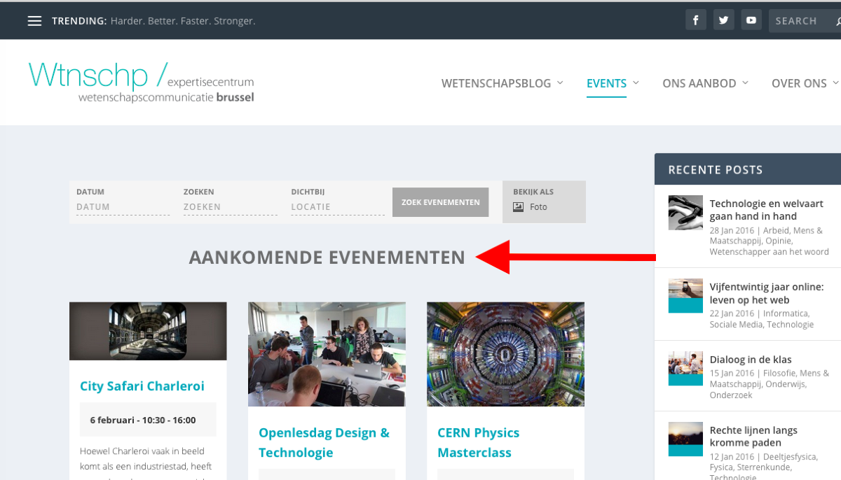

So to help ensure we’re referring to the same exact string, can you take a screenshot of the exact “Upcoming Events” phrase on your site that you’re referring to? You can then share image here by uploading the screenshot to Imgur.com, Flickr.com, CloudUp.com, or any similar image-hosting site; then just share the links to those images here and I’ll take a look.
GeorgeFebruary 2, 2016 at 6:41 am #1066378Bart
ParticipantHi, I’m talking about the one on top of the main calendar: http://www.wtnschp.be/events/
February 3, 2016 at 12:54 pm #1067231George
ParticipantFebruary 3, 2016 at 12:59 pm #1067235Bart
ParticipantYes, that’s the one. It’s in Dutch as WordPress is set to Dutch. (and at the moment, I have added your code to the functions.php file)
February 3, 2016 at 1:16 pm #1067243George
ParticipantThanks for confirming, @Bart! Sorry for the back-and-forth on this.
I’ve modified the original code snippet a bit and hope that this version helps!
add_filter( 'tribe_get_events_title', 'tribe_alter_upcoming_events_title' );function tribe_alter_upcoming_events_title() {
return 'Something Else';
