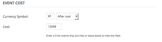

    Admin cost field
    In the admin-facing cost field for events, just leave your prices without spaces in them. So, to use your example of 12 599 Kč, you would enter this in your edit-event screen as 12599. Here’s a screenshot of this:
